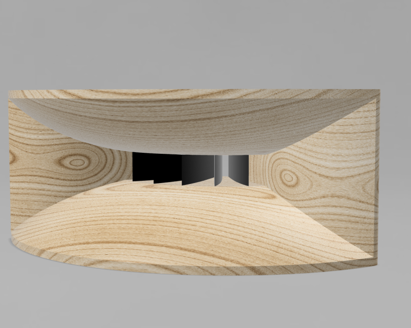

I would like to point the attention to my new fin horn design which is free for use:
https://sphericalhorns.net/2023/04/09/th...-fin-horn/
