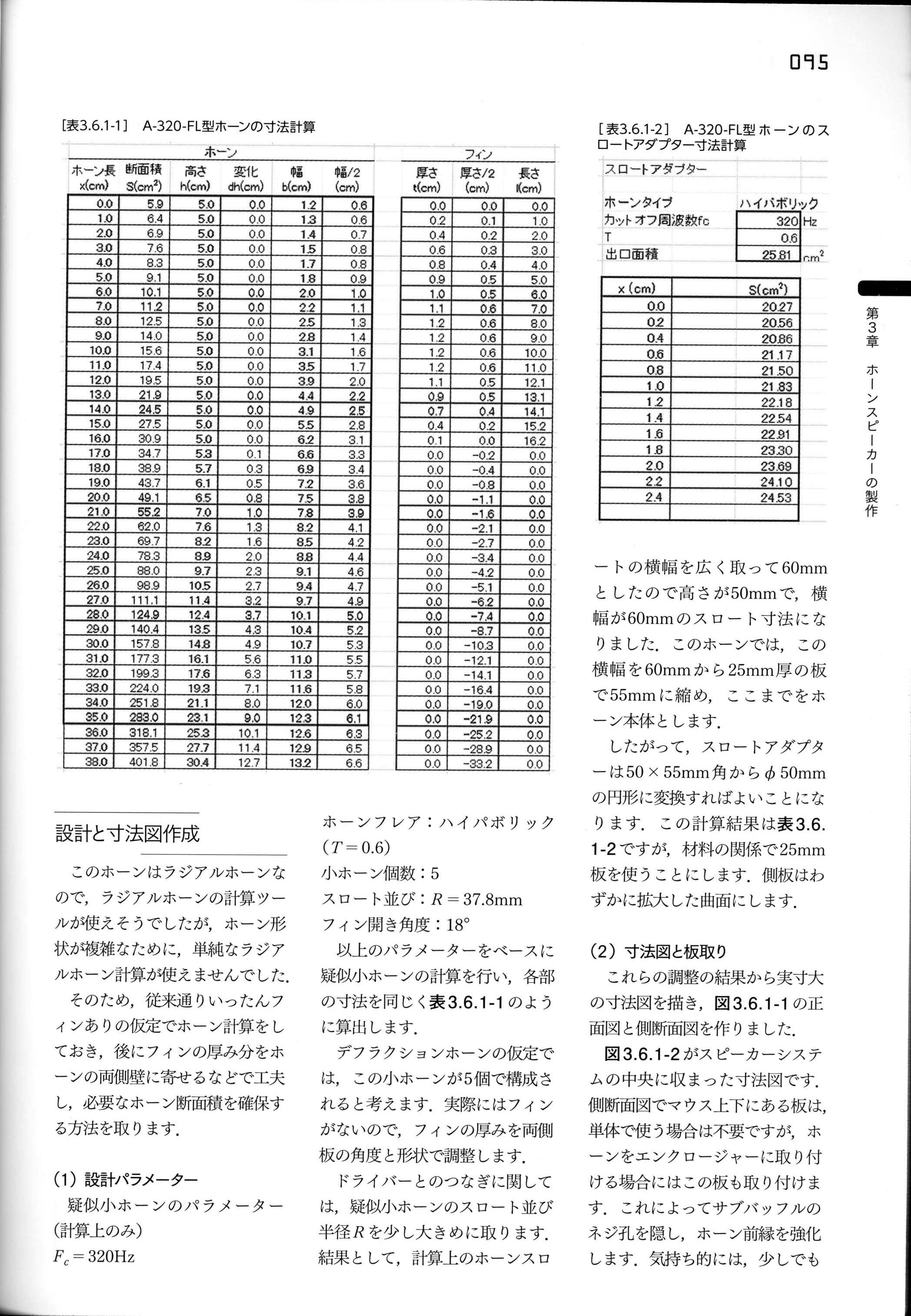

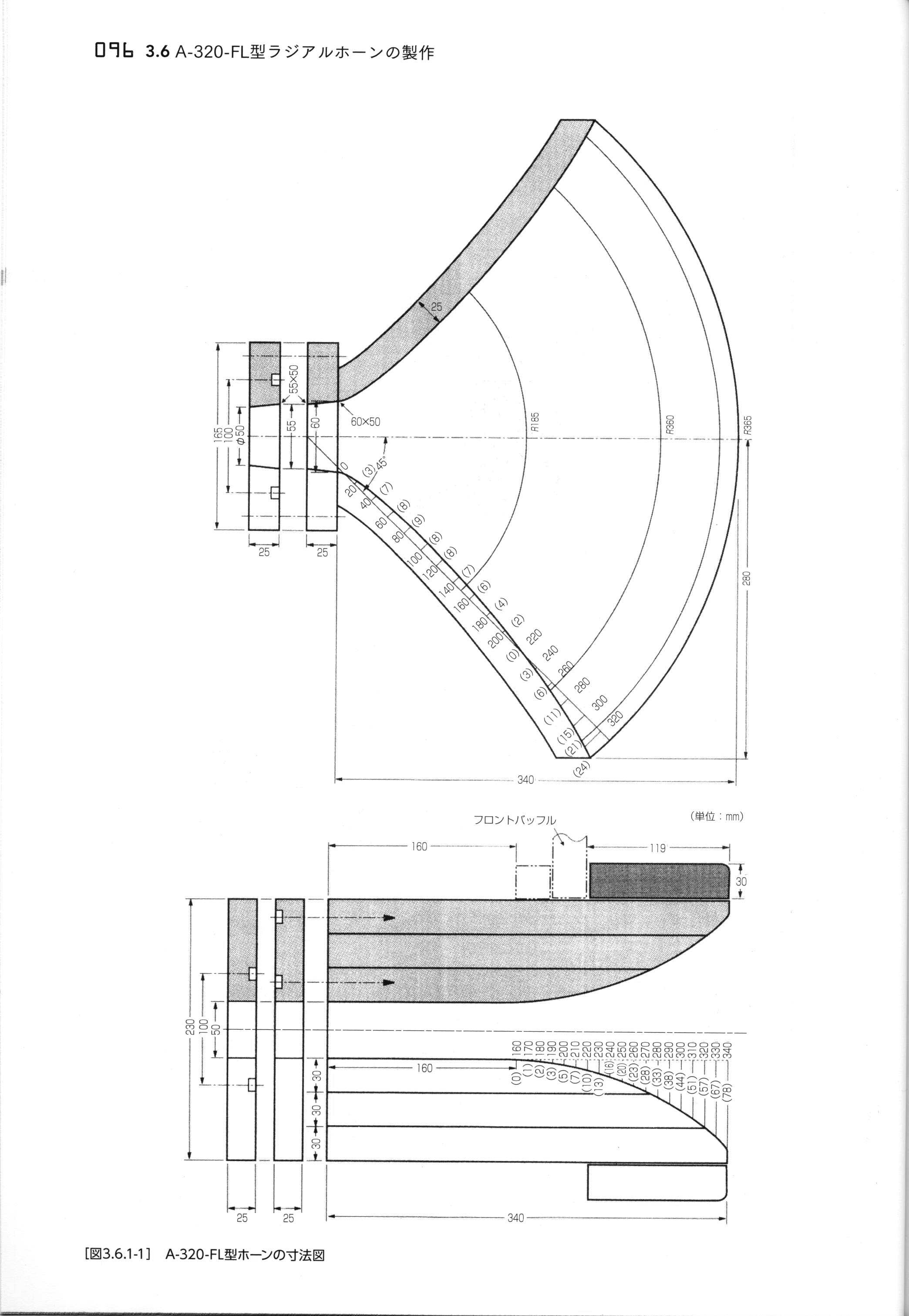

Pour moi c'est un Arai A320FL
Cdt.
AleX
https://forums.melaudia.net/attachment.php?aid=25715
https://forums.melaudia.net/attachment.php?aid=25716
https://forums.melaudia.net/attachment.php?aid=25717
https://forums.melaudia.net/attachment.php?aid=25718
https://forums.melaudia.net/attachment.php?aid=25719
https://forums.melaudia.net/attachment.php?aid=25720
https://forums.melaudia.net/attachment.php?aid=25721
https://forums.melaudia.net/attachment.php?aid=25722
https://www.homebuilthifi.com/project/18865
