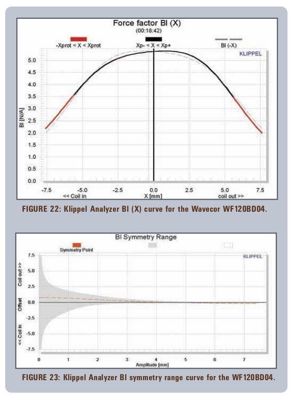

Wavecor WF120BD04:
Klippel analysis for the Wavecor 4.75� woofer produced the Bl(X), Kms(X) and Bl and Kms symmetry range plots given in Figs. 22-25. The Bl(X) curve for the WF120 (Fig. 22) is relatively broad and symmetrical, especially for a 4.75� diameter driver, and obviously also with “tilt�? that includes a small forward (coil-out) offset. Looking at the Bl symmetry plot (Fig. 23), this curve shows a 0.8mm coil forward offset at the rest position that decreases to 0mm at the physical 4mm Xmax of the driver. Figures 24 and 25 show the Kms(X) and Kms symmetry range curves for the Wavecor midbass woofer.
The Kms(X) curve definitely has some asymmetry, and also with a minor rearward (coil-in) offset of about 0.8mm at the rest position that decreases to 0.25mm at the 4mm Xmax location on the graph, and increasing somewhat out to 6mm or so. While these numbers are small, it does limit the distortion levels somewhat. Displacement limiting numbers calculated by the Klippel analyzer were XBl at 82% Bl greater than 4.3mm and for XC at 75% Cms minimum was 2.3mm, which means that for this Wavecor woofer, the compliance is the most limit- ing factor for prescribed distortion level of 10%. This isn’t that much of an issue, especially because this woofer could easily find itself working as a midrange in a three-way product.
Figure 26 gives the inductance curve Le(X) for the WF120BD04. Inductance will typically increase in the rear direction from the zero rest position as the voice coil covers more pole area; however, the WF120 inductance stays most- ly constant as the coil moves in due to the dual shorting ring configuration. The inductance variation is only 0.05mH from the in and out Xmax positions, which is very good.
