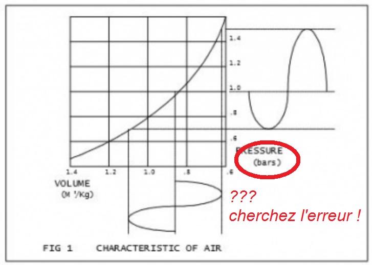

forr a écrit :Le post 27 de Petier T présente un argument très sérieux contre la pertinence de l'assymétrie de la pression sonore compensée par un ampli :
I have never understood the motive for single-ended amplification "because of the single-ended nature of sound propagation".
The asymmetric character of sound will be recorded "asymmetric" as well. The reproduction chain (amplification; loudspeaker) should not contribute in an "asymmetric" way therefore IMO, so I don't see a task there for single-ended amplification.
Qu'en pensez-vous ?
