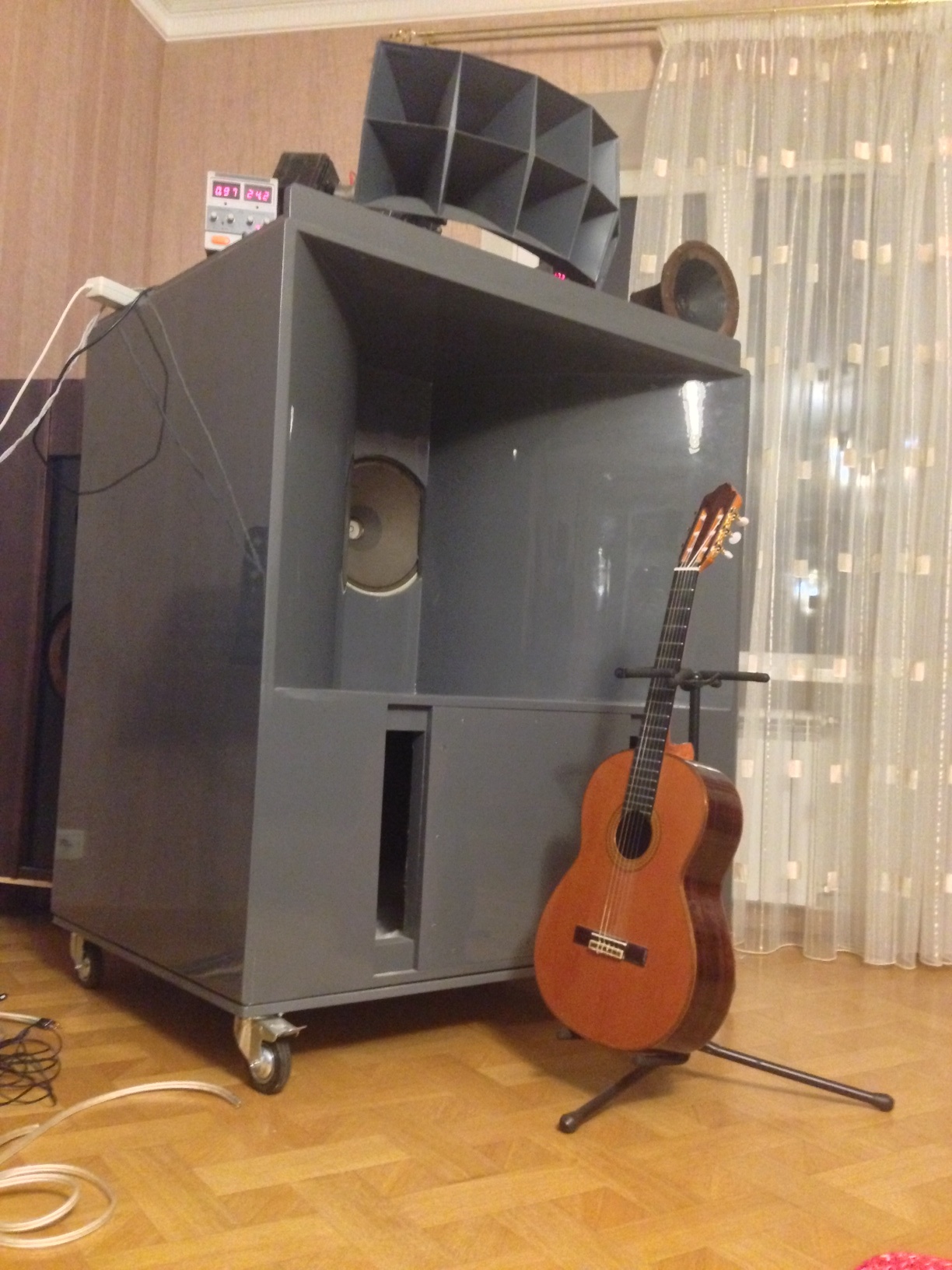

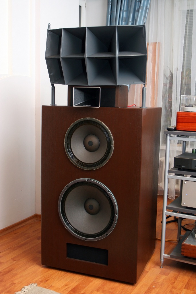

Hi Francois and Raoul !
Yes it is, English is much better for me! For Franch I have to use Google translator
My current home made speakers are on the picture (Altec 416z + Altec 414 + Altec 288K/805B + BMS 4552ND)
I just finished building my new home and I'll have much bigger room for my setup - 5m x 8,3m x 3m and I would like to build new loudspeakers with LF horn. I was thinking about VOTT 825 cabinets? but after I saw your H110 cabinets I fell in love with them!!!
I will be very grateful for any information about H110 - drawings, detailed photo, etc.
Regards, Mikhail

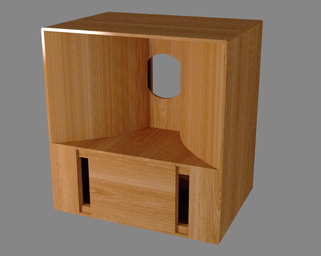

hello mikhail
my english is very poor, i try but,I apologize in advance for the fault of syntax.
you have a formidable set of altec speaker, it looks very good.
for 3 days i am on the road, i come back this weekend and i can post for you somes pics,and drawings.
for waiting i post a bad drawing, there is some mistake compared with the final version
[attachment=6133]
regards
francois

Hello Francois!
Thank you very much for your reply! I will be waiting! My e-mail is mike (at) r3bm.ru
With best wishes,
Mikhail

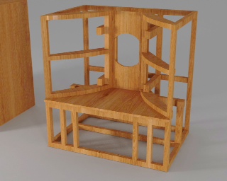

bonsoir
j'ai correspondu avec mike en privé.
Il m'a envoyé de très beaux plans,fait par un ami a lui, qui a construit une H110.
les dimensions en auraient été relevées par un correspondant américain,a partir d'un modèle original, (si j'ai bien compris).
il m'a autorisé a vous en faire profiter
h110 drawing.pdf (Taille : 1,23 Mo / Téléchargements : 1.786)
il sont fort ces russes
bien cordialement
François
