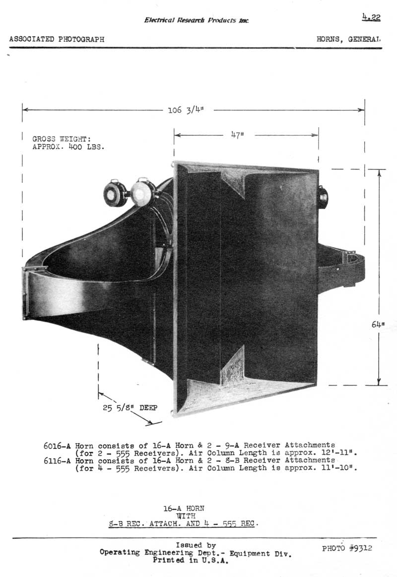

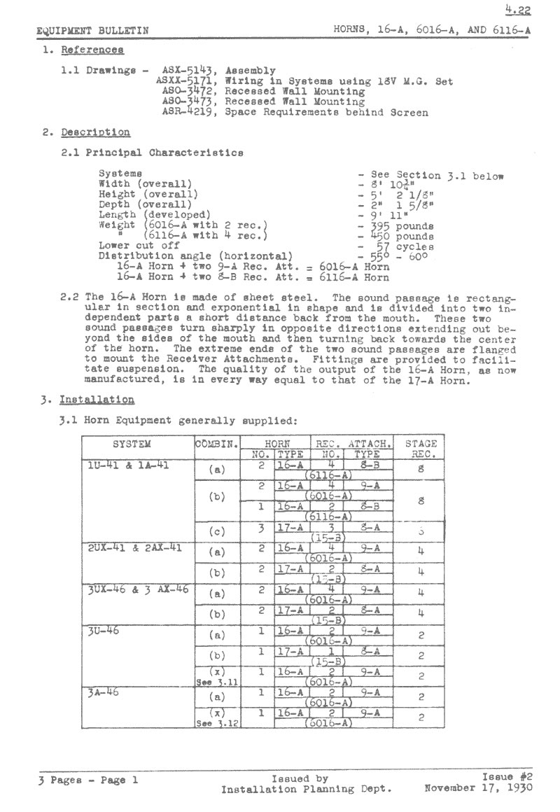

En ce qui concerne le WE 16A, le problème est semble t'il différent, on a deux pavillons indépendants qui se rejoignent dans une même bouche. Utilisé de nos jours en " stéréo " comme chez tim, le résultat est assez bluffant.
Le 16A à une version a 4 we555 baptisée " octopus "
"Introduced in 1929, the Western Electric 16A horn is a product of the early days of talking motion pictures. The 16A was intended as a compact solution for a horn speaker system to be mounted behind the movie screen hanging on chains. At 400 pounds and almost 3 meters wide, the idea "compact" is relative. The WE 16A could be loaded with either two or four WE 555 field coil compression drivers. This horn has a unique dual horn construction which allows it to be used today for single point stereo. The Western Electric 16-A Horn was available in two different configurations. The Part number 6016-A Horn consists of 16-A Horn and 2 9-A Receiver Attachments (for 2-555 Receivers). Air Column Length is approx. 12"-11". The Part number 6116-A Horn consists of 16-A Horn and 4 8-B Receiver Attachments (for 4-555 Receivers). Air Column Length is approx. 11"-10". "
http://www.audioanthology.com/audio2.htm
http://www.silbatoneacoustics.com/WE16A.html
l'article de jean hiraga a propos d'une instalation avec 2 16A
