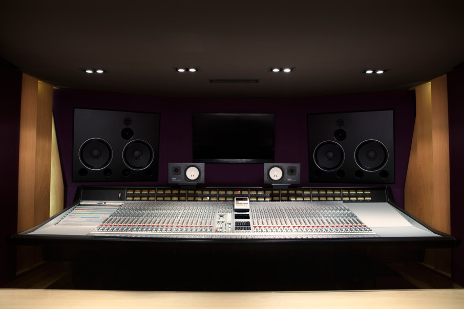

un autre , studio -de- la- Chine , très intéressant :
http://www.magazine-audio.com/amadeus-au...e-a-paris/
REPORTAGE, LE STUDIO DE LA CHINE :
https://deveniringeson.com/studio-de-la-chine/
https://www.psneurope.com/studio/custom-...e-la-chine
http://studio-de-la-chine.fr/
Paris’ Studios de la Chine – home to France’s only SSL 9072 J console – has installed a custom pair of Amadeus speakers inside its main control room.
"It took us a long time and lots of experimentation to find the perfect cconstruction technique,
which is extremely complex, and results from the combination of the materials used and the skills of the craftsmen at Amadeus,”
said Amadeus’ Michel Deluc, who designed the loudspeakers. “Each custom studio monitor is built around a unique internal reinforcement structure,
designed to neutralize any 'standing waves' and to suppress energy loss caused by vibrations.
Each speaker's multi-layer panels combine a subtle blend of woods, high-density bitumen, 'elastomers' (polymers) and mineral fillers.
" The monitors feature one 1-inch dome tweeter made of a 99% pure beryllium diaphragm,
one 3-inch ATC soft dome mid-range driver and
one 15-inch low-frequency TAD direct radiating woofer.
"The speaker's frequency response ranges from 28–30,000 Hz,
" said Deluc. "This 3-way monitoring system is driven by a proprietary tri-amped power amplifier section, which uses a high efficiency,
full resonance, switched-mode power supply. The amplifier includes a built-in DSP module,
with digital filtering functions such as system EQ, time alignment between HF and LF sections,
limiter parameters, thermal protection of the transducers, and more." Leonard RaponiI,
record producer, arranger and music conductor added: "A few months ago, I discovered the Studios de la Chine recording and mixing
http://amadeusaudio.fr/fr/155.php
The amplifier includes a built-in DSP module, with digital filtering functions such as system EQ, time alignment between HF,
MF and LF sections, limiter parameters, thermal protection of the transducers, and more...
SPÉCIFICATIONS
Amplitude linearity (±2dB)
30 Hz - 20 kHz
Cut-off frequencies (-6dB) 24 Hz - 30 kHz
Max. continuous SPL 124 dB
Transducer (HF) 1 x Beryllium 34-mm Soft Dome tweeter
Transducer (MF) 1 x ATC 75-mm Super Dome mid driver
Transducer (LF) 1 x TAD 375-mm bass driver
DSP type Analog Devices SHARC DSP
Amplifiers Output 3 x 1000W (8Ω) Class-D with PFC System
http://amadeusaudio.fr/fr/355.php
http://amadeusaudio.fr/fr/index.php

Merci pour les photos Wink
Crdt

Merci Mastro pour ces liens fort instructif ! Et notamment loin des compressions et ampli classe A !
Ampli classe D avec une grosse alim
DSP basé sur des puces shark
Medium et tweeter à dome, bon ok des customs coutant un bras
