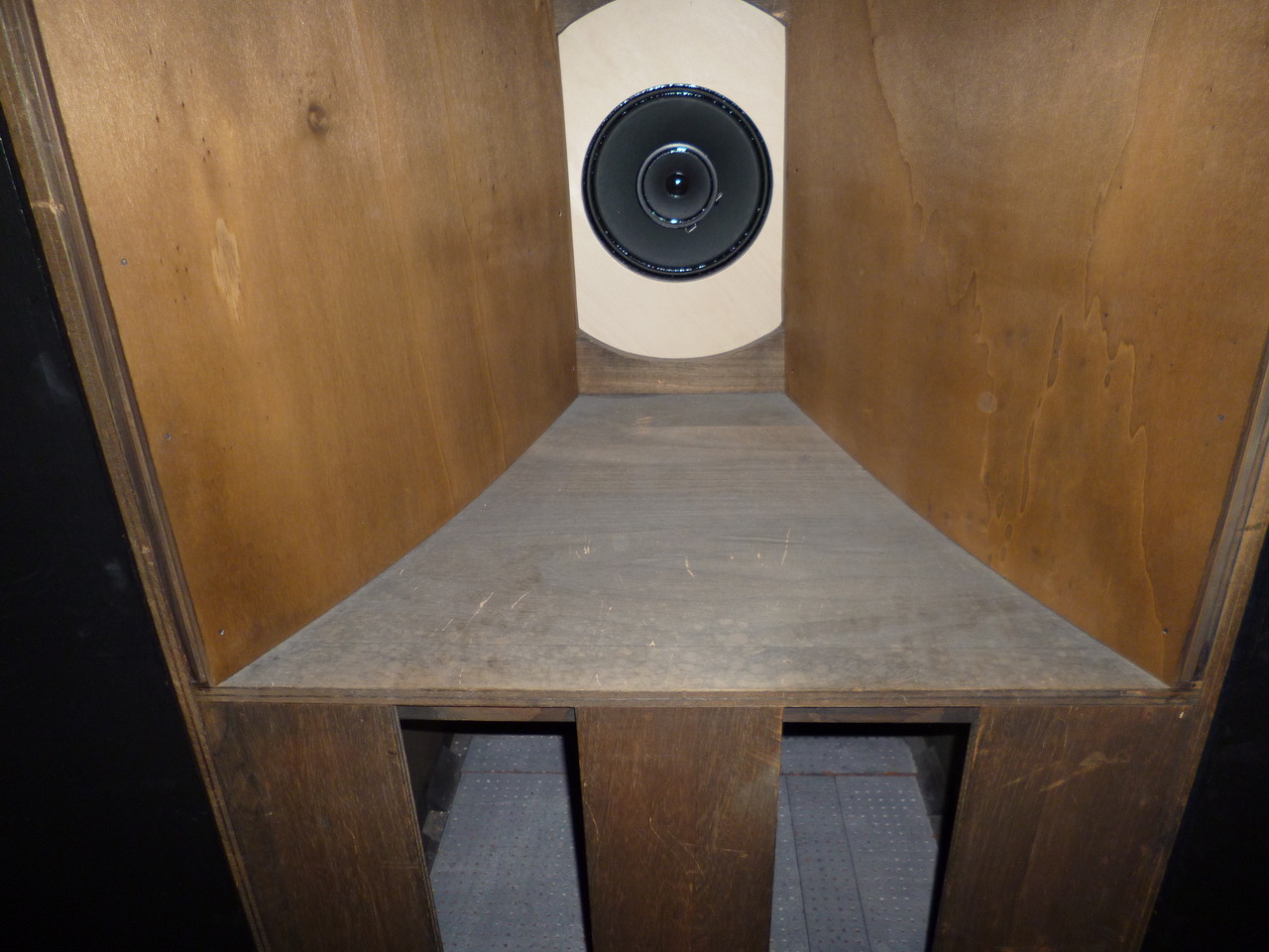

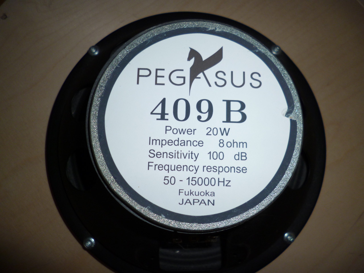

Yes, since the thread does not fall asleep, I'll show you a tip - Plug and Play - Yes, in the truest sense of the word.
The idea with the Pegasus 409B coaxial chassis in the cabinet Altec 825/828 comes of course from Japan. I tried it.
There are two excellent options. You can, among other things, leave the top half of the two-piece back of the VOT open. And again there is a very special sound. There was something similar from Western Electric.
The 409B are compared to the Vintage chassis, drivers, crossover horns, which is always a small lottery, but is reasonably priced.
Sonically? It plays very well with the 300b Bee Pre from Bottlehead and the Verdier Spirit 300b Luxe. Balanced up to 15 kHz with an incredibly deep, tight bass. Something with an 8 "coax chassis. Well, try it, plug and play.
